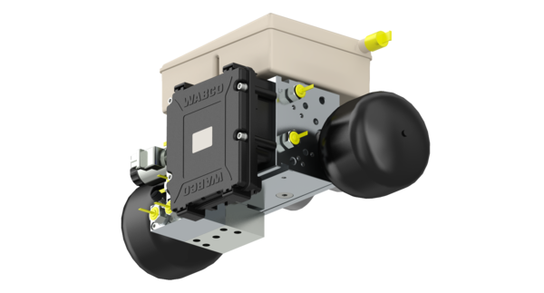

    I have a bus in the shop with Wabco Full Pressure Hydraulic brakes. It was towed to the shop
    after someone butchered the wiring harness and swapped the brake ECU from another vehicle.
    I replaced the fuses and smoke started coming out of the ECU. I ordered a complete
    Hydraulic Compact Control Unit for it.
    Meritor says not to manually bleed the system that it must be pressure bled.
    I need an adaptor to pressurise the brake reservoir. That item seems to be unobtainable.
    Even the Snap-On dealer could not supply us with one.
    There are a lot of these brake systems on the road what are mechanics using to bleed them?
    Its just a cap that goes on the filler neck on the reservoir on the master cylinder.
    I bought a 18" length of 2" round aluminium and spent a couple hours last night machining the lock ring.
    It was a real pain machining the bayonet lugs. A 1/8" end mill running at 900 rpm. I cut a snap ring groove
    in it and I made it in two pieces.
    The finished lock ring waiting for some final deburring.
    A little touch up with a file and the ring fit perfectly. Made the rest up and pressed it together.
    The manual says to put 35 PSI in the plastic reservoir and if you have difficulty bleeding the brakes raise
    the pressure to 45 PSI. A 20 year old plastic brake reservoir. I can see where that could be very messy.
    I think I will do that with the hood closed.
