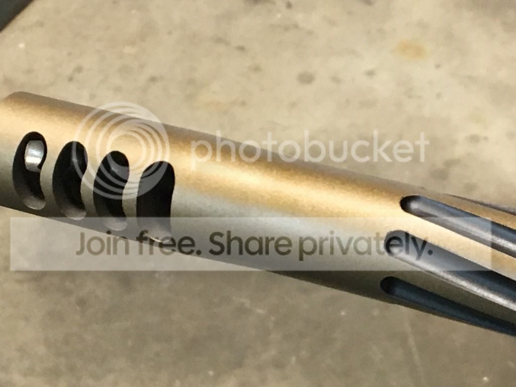

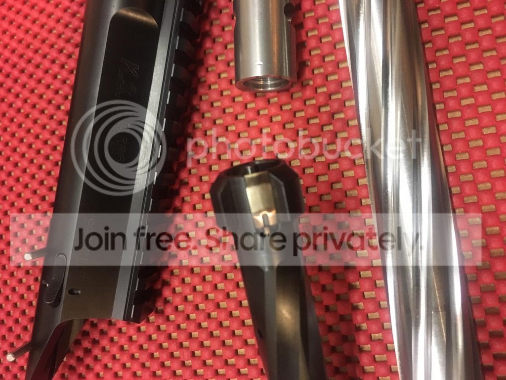

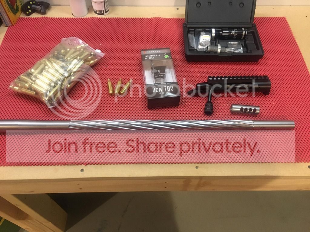

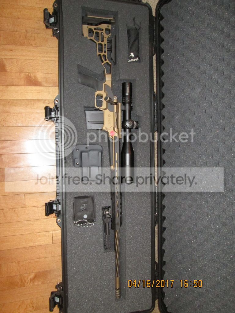

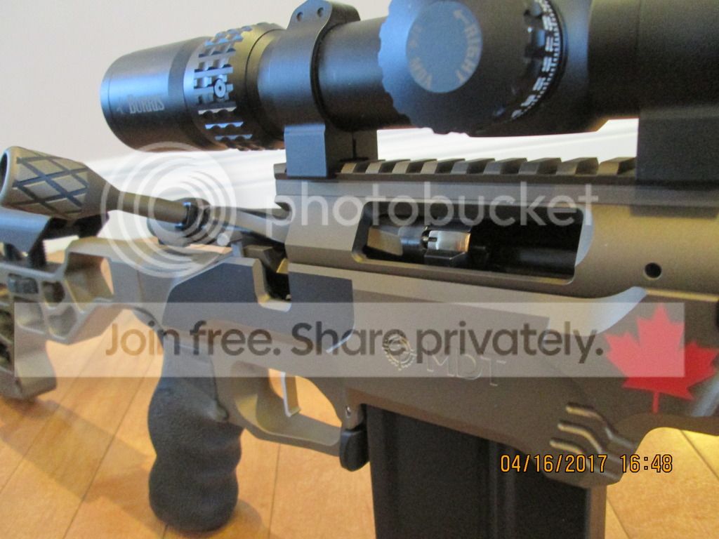

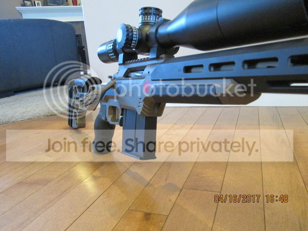

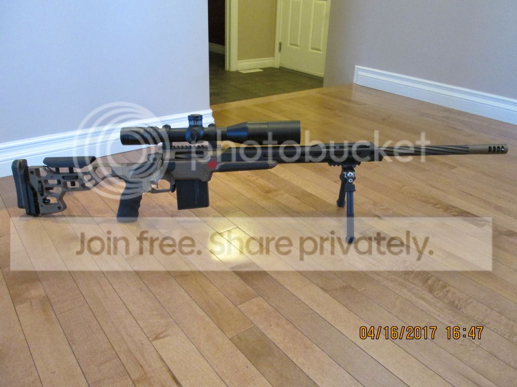

So this is going to be my own personal PRS rifle for this season. I am fortunate enough to have been supported in the build by several sponsors for this season so I figured I would start a build/progress thread as we get going on this one.
Thanks to KS Arms and MDT for sponsoring our build as well as the rifle we will be giving away at the Poker Rally this year.
For anyone interested, we have decided to pick up the GAP 6.5 SAUM 4S reamer. We also will be stocking Whidden 6.5 SAUM dies and we have over 1000 pieces of the newest batch of the Hornady 6.5 SAUM 4S brass in stock.

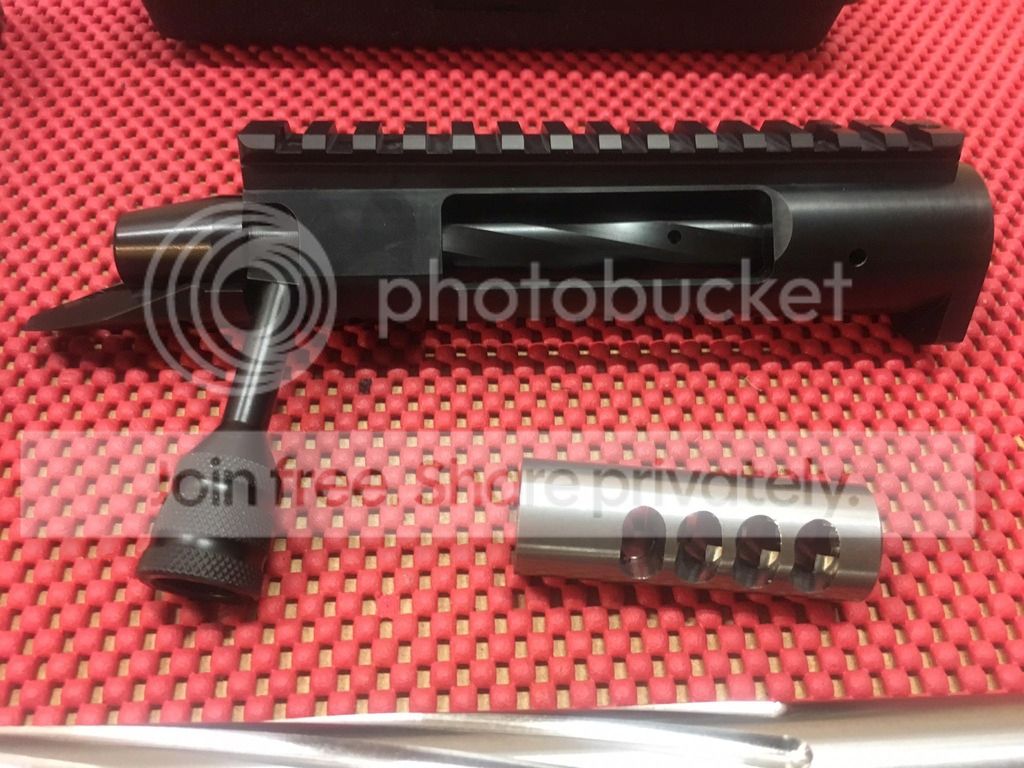

Build Specs:

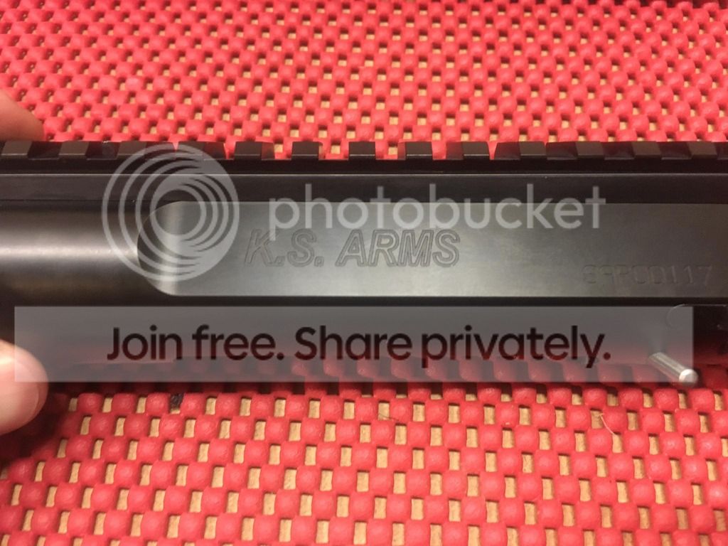

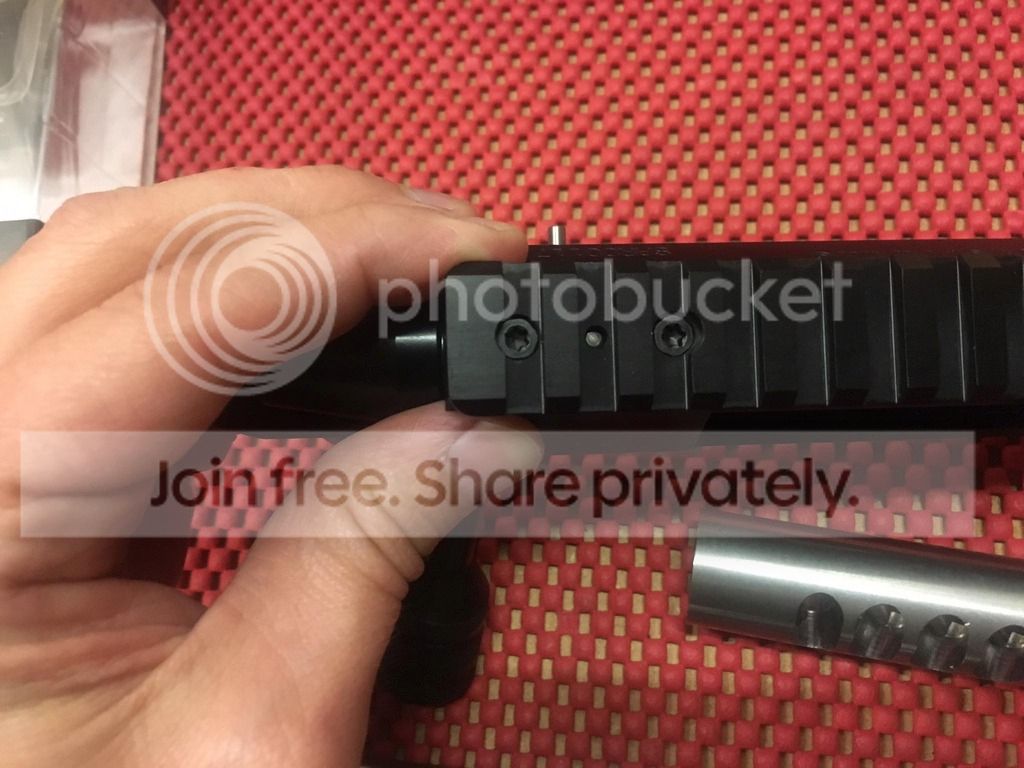

KS Arms Action - 3-Lug, Remington footprint, integral recoil lug, pinned 20 moa rail, hard nitrided, spiral fluted bolt

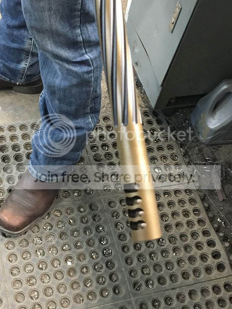

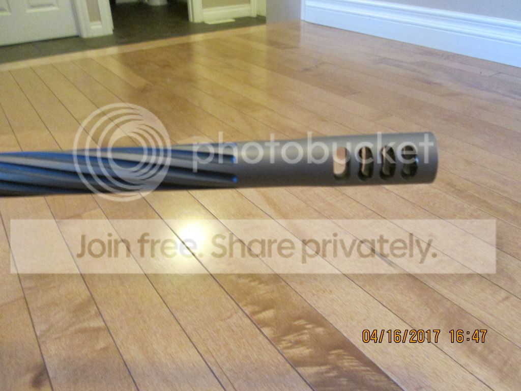

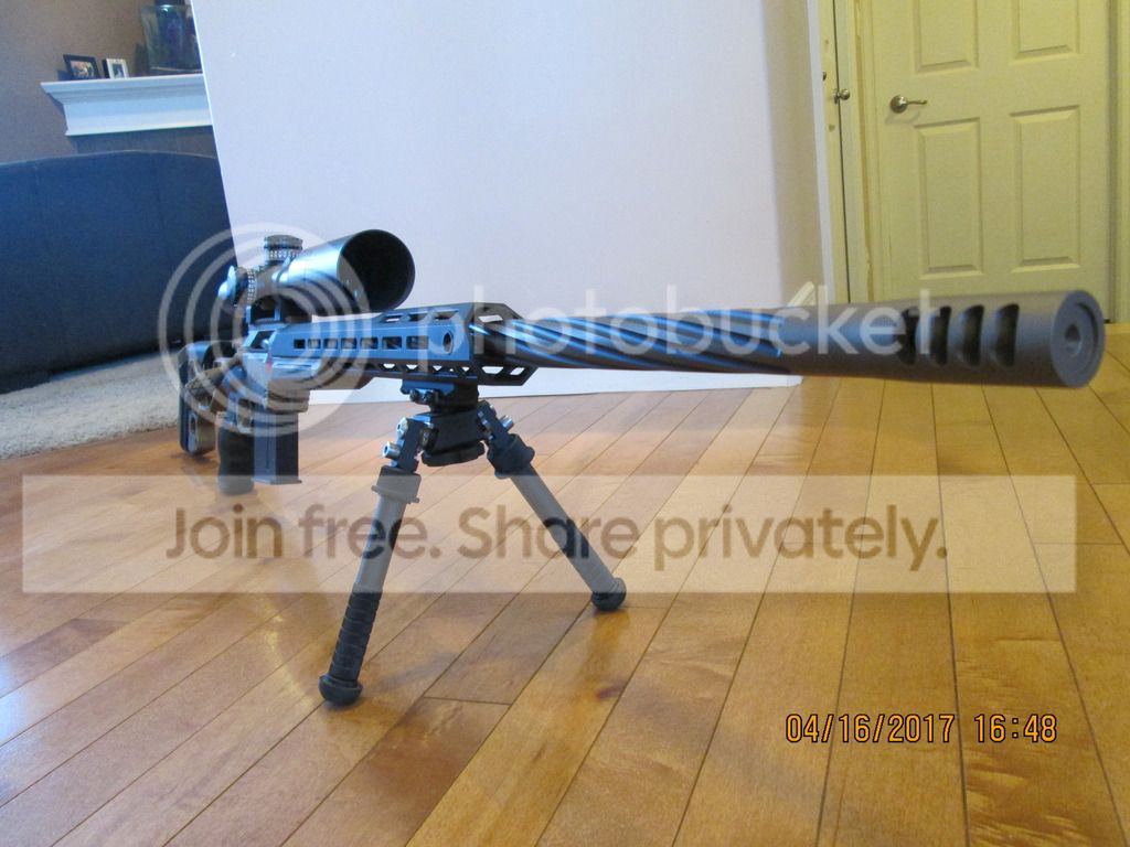

KS Arms Barrel - 25", 1:8 twist, 5R, spiral fluted, heavy palma contour
MDT ESS chassis - 15" no rail forend
Trigger Tech - Primary Flat trigger
EMP Sparc 4 Port Brake
Accurate 300wsm 7rd magazines
Burris XTR II 4-20x50mm - Horus H59
Whidden Dies
Hornady 6.5 SAUM brass

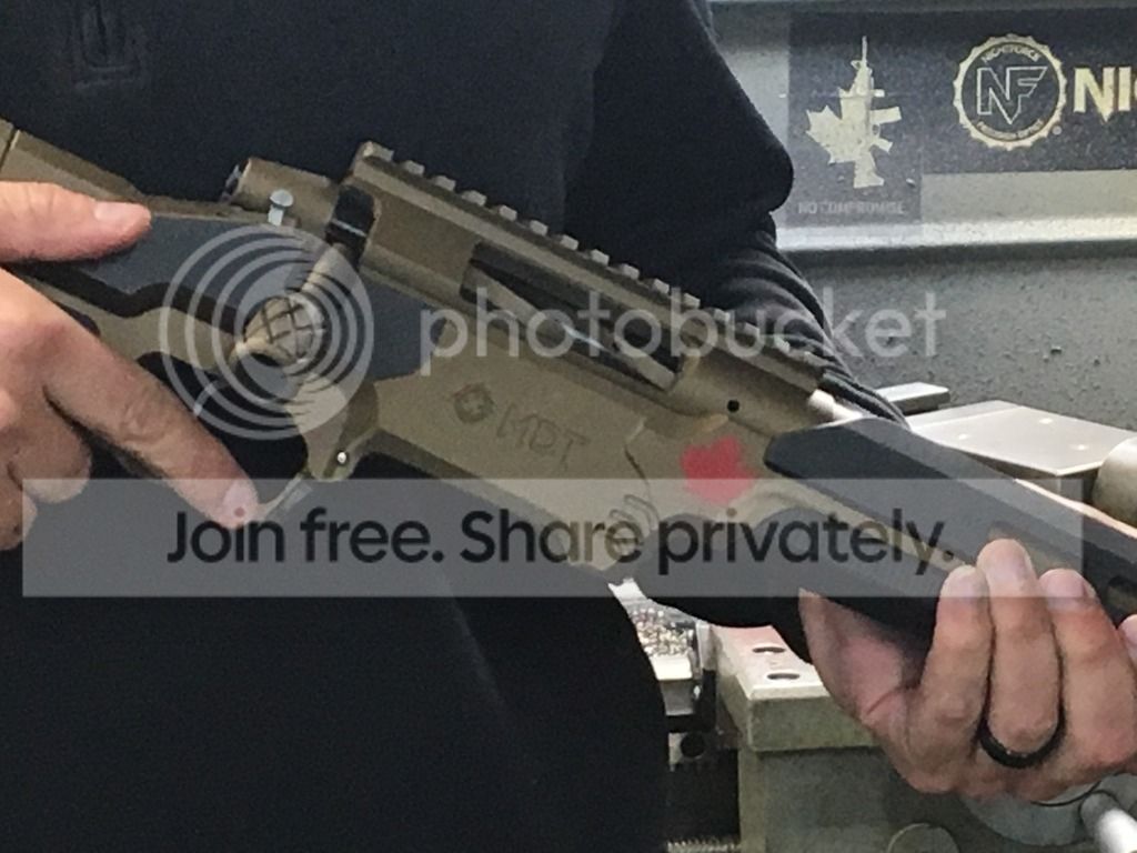

So 3 days for Steve to get this one done....not too bad.
Better pics to follow once I get some time. Headed to Calgary for the Gunshow tonight.
