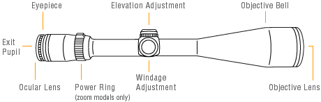

I might be getting ahead of some folks with my descriptions. The following diagram might help a bit.
In a 3-9X40 scope, the 3 means three power, or 3X. This means that the image you see through the scope appears three times (3X) closer than it does with your naked eye. The 9 means nine power, or nine times (9X) closer than it appears with your naked eye. The forty (40) is the objective lens diameter in millimeters. This is a variable scope because you can vary the magnification of the scope from three to nine, stopping anywhere in between. You would describe this scope as a "three to nine by forty."
Most scopes, especially in America have main tubes that are one inch in diameter. That means that they use one inch rings. Some scopes have thirty millimeter main tubes. Those scopes will use thirty millimeter rings. There are several main types of bases that are used to connect the rings to your firearm. You need to know what kind of base you have to find out the exact type and height of the one inch or thirty millimeter rings you will use for your specific scope.
