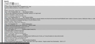

8) "What's new at GOC", Tab changes instantly, but body of page shows this
In Firefox, going to "about:cache" to get the cache file directory, and then going to File Explorer and deleting the contents of that directory ("Disk" "Storage disk location", i.e. the most thorough way to clear the cache), had no effect on resolving that.

The main page loads fast and displays correctly:
If slect the "What's New at GOC" tab, the page takes 5 to 10 seconds to load and displays incorrectly:
Wile the displays is wrong, the search only takes 0.03 seconds, if I click the last message icon (>>) for any of the threads on this page, the resultant page is correctly formated but take 5 to 10 seconds to load.
My home page looks like that also. Now, it seems that the lagging occurs only when I go back to the home page. From there, and within threads, things appear to be normal.

Seeing this also when I click "What's new..."

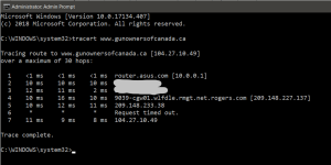

And finally, trace route:
This site is the only site I visit that is slow/corrupted.

I just tried Chrome, and it made no difference at all. Same speeds, at the same spots, and the same incorrectly displayed "What's new at GOC" page.
I just tried Internet Explorer (with scripting disabled), and it made no difference at all. Same speeds, at the same spots, and the same incorrectly displayed "What's new at GOC" page.
